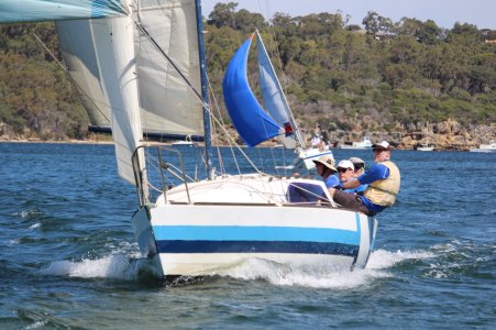

PS a couple of photos from last Sunday. First shows stowage of spin pole (a section of wind surfer mast ) means topping lift is always attached so can't lose pole over board.

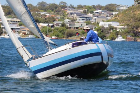

second shows if you look closely the down haul arrangement as a barber hauler on the brace. I found more successful when shy than a down haul on pole. ol'will
