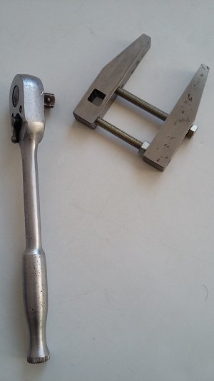

Below is my home made solution. A toolmakers clamp with a 1/2inch square hole used in combination with a long 1/2" extension and a 1/2" ratchet driver:-
