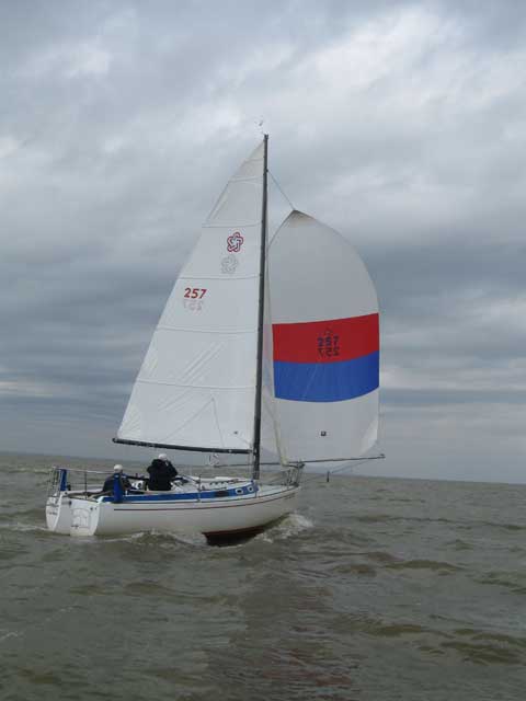

I have a Freedom 21 as my spare home port boat for racing around and taking the kids out, it is amazing how easy it is to deploy, retract and use the spinnaker whilst sailing single handed with no prep other than attaching the main halyard, it's almost as easy as rolling in the genoa. Just a shame the racing rules don't allow this specification as it balances out with restricted upwind sailing and would compete fairly with other boats using traditional spinnakers.Sea Wolf.jpg
