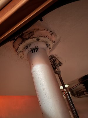

Hi here is an image of my Hoyt boom set up between decks, glad I had a look as I have evidence of water ingress, I’ll take the nylon rings off, clean and apply some sealant.
Does your boom finish at deck level ?

No, mine is all above deck, just six bolts though the deck holding it down. Yours looks very different.
