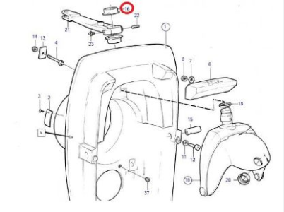

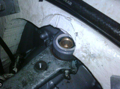

No part 23 is the grease nipple you can see it at the bottom in the photo, worth pumping some grease in and seeing if it makes a difference. However if it hasn't been done for a while it might need new bushes which is a boat out job.
I would also check the cable run as something could be crushing or kinking it somewhere which could make it stiff.

ah yes i can see it now, thank you. So I just need to plug a small hose on and pump in some grease? Any particular type?
