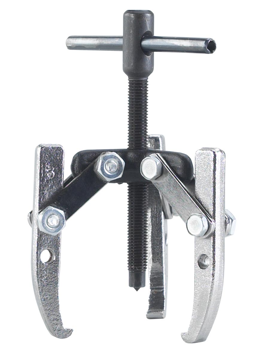

I use one like this.
attachment.php
But you could also use a jaw puller
https://www.google.co.za/search?new...2-1j0j2.3.0....0...1c.1.49.img..6.2.717.mI9Qk
One problem I can see is that there is very gap between the prop hub and rope cutter so you may need to slacken both and pull then both off together.
Sometimes the forward edge of the prop is rounded or chamfered and a three leg puller like the one shown will not stay on. You may find that a big hose clip around the legs will help.
