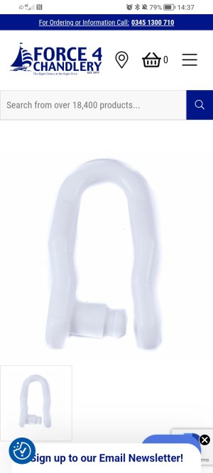

Hi I noticed as I was raising the main that one of the plastic shackles mid way up had clicked open. I tried to use my leatherman pliers to close it, but they were too small. Do I just find a bigger pair of pliers or is there a trick to re-closing them without taking the whole sail down?

If it's not behaving consider replacing with a lashing.
I don't think those things are ever the same once they've been used and torn open.
You can close them with something like a G-clamp, small vice, waterpump pliers maybe?

Plumbers grips are best to close them as they have the angled jaws and long handles to put pressure on.
If you want to make sure that clip stays secure but still possible to remove later ... press together fully ... then take smallest self-tapper in stainless steel and screw it in from outside between the pin and outer - locking the two ...
Later you can just remove the screw and unclip.

Use some sort of adjustable pliers, or also by hand pushing with one thumb over the other. I have them on my cockpit side clothes, they are >15yo and still going strong, opened/closed once or twice a year. Actually more difficult to open them, I insert the pliers long handle and twist them.
