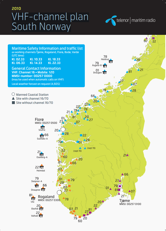

This information is for the Norwegian sector.
Some practical information first, if you try to go near an oil installation the safety center will try to contact you on VHF 60 min before entering the safety zone which is 500 meter radius.
The fixed installations is marked by name in the maps, like this (follow the link), and they have manned radio stations on board.
http://www.norgeskart.no/statisk.html#6/-256489/6515864/-land/+sjo/+embedMaskLayer/+pekere+embed.box
The movable ones have got AIS, so with a AIS receiver you you can get the MMSI numbers.
In Norway we have five manned coastal radio stations that cover the Norwegian coast including Jan Mayen and Bjørnøya.
Rogaland and Florø radio have remotely operated installations on the oil platforms to extend the coverage.
VHF-channel plan South Norway
http://public.asphost.no/lastned.asp?dokument=153
VHF-channel plan Northern-Norway
http://public.asphost.no/lastned.asp?dokument=154
VHF-channel plan Nordic countries
http://public.asphost.no/lastned.asp?dokument=170
So if I was close to the Sleipner-A platform I would call Rogaland radio on ch 79 directly (for normal traffic).
For some odd reason these pdf wont open on my phone, but work fine on the laptop.
IMG link http://i372.photobucket.com/albums/oo167/knuterikt/VHF/VHF_SouthNorway_zpsd0b7b5d1.png
If there are coastguard repeaters operating on oil rigs then they are not part of the owners equipment and if in range of such a station
You call the relevant shore master station. IE Rogoland Radio if they are transmitting from it.
The rig itself may well have an MMSI number however this may not be connected with the coastguard radio which will probably respond to theRogoland. MMSI

I have no additional facts to add, but this seems like the right answer. Just as Solent Coastguard having an additional aerial at the Needles doesn't mean you call "Needles Coastguard", a repeater that happens to be mounted on an oil rig doesn't mean you call the rig. The sea area designation is about what equipment you need to communicate with the MRCC covering the area - it's still the MRCC that you talk to regardless of how their coverage is implemented.
