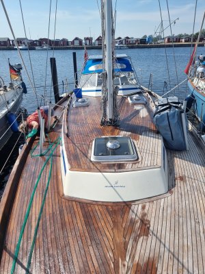

MattK1969
22 Aug 2022
40
After having an old teak deck for a few years I have learnt;
1. Never sand it, you are just accelerating the wear process. After sanding it soon looks like you didn't sand it.
2. You can remove the screws and glue in new plugs no problem.
3. Use the two pack teak cleaner, which is basically bleach followed by oxalic acid. It looks great after this, but this does accelerate wear a bit IMHO.
4. Don't scrub as a matter of course, you will wear it out.
Picture shows recent two pack teak cleaner application. Don't sand it!!
