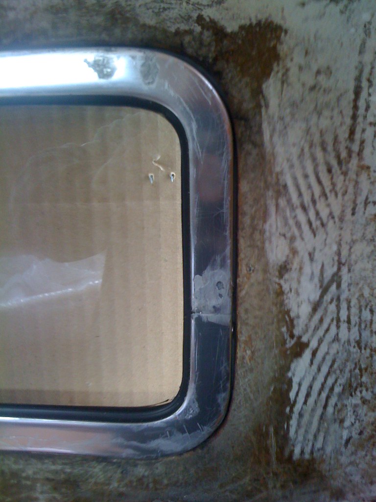

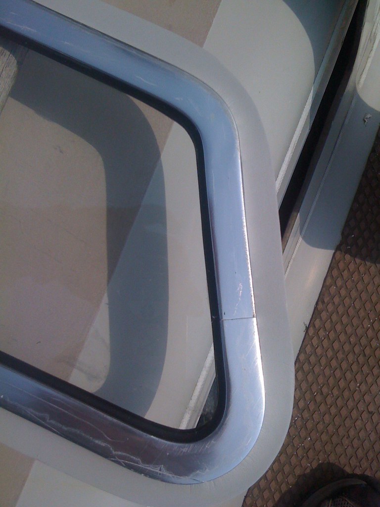

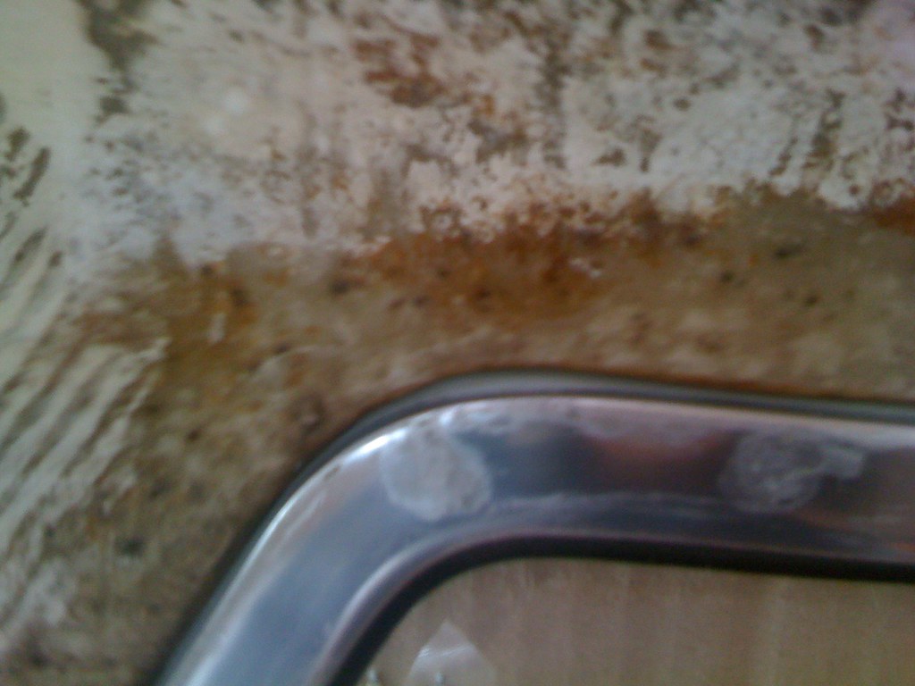

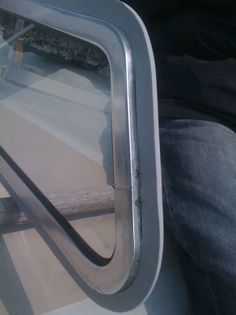

I am trying to replace the seals. The seam is at the bottom of the window frame in the middle, on the inside there are two small holes on either side of the seam./ends. Are these for pins or screws, if so they are pretty corroded.

Some pics: -
OK spoken to Jean Pierre at Hadlow Marine who says my windows are not designed to take apart as mine are pressed onto a fish plate not screwed in. I only have one seam so would have to bend the frame to get the glass out so as suggested I a, leaving well alone, will cut the old seal out and Jean is advising I use Arbosil ten, zero,nine,six... sorry IPad not doing numbers at the moment! And Scapa three,five,zero,seven slash twelve to fit frame to boat! Good enough for me. Interesting he is not saying sikaflex as he used on yours BOB!
Thats good news because now you know and before any attempt to split the frames damaged them. With care I am pretty sure you will end up with a better sealed window than original and neater looking. Take the time to get the sealant out through any corroded holes in the frames so that they are sealed. Make sure the glass is secured in place first before totally filling the frame, say with blobs of sealant to glue in position while supported with shims of wood. Something like that.
