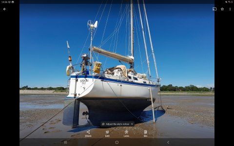

Only done it in a long keel with legs , same principle. I like to set an anchor down hill in the direction of my exit so once I start to float I can quickly pull myself into deeper water . Prevents any bouncy bouncy on the flood
