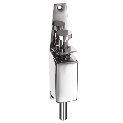

I did buy a couple of door stops (of the press a rod to hold on the floor press a small blade under it to unlock) but realised that first of all the door is elevated about 80mm from the floor so the thing wont work (doh!) and second even if they would work I'd not be able to operate them barefoot.
So scrapped the idea and realised I have no other option to using an awful door lock like this:

sorry, still confused, stoppers screw to the frame: you mean to the immovable part of the door, or the frame of the actual sliding door?
If the former, I struggle to see how it blocks the door from moving, if the latter need the floor nearby and it's 80mm down as pete asks.
Vas, are you saying there's a 80mm gap between the bottom of the door and the floor?
yep, I may have a solution though as I have a spare piece of iroko and was thinking of actually widening this lower door frame to something more substantial so I may end up adding a 45X80 piece inside in which case Bandit's solution may work.
