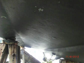

Hello all,
So I'm about to buy a 45 footer that has been surveyed and has undergone sea trials. Everything went well, but I am concerned about the surveyor's reports of blisters. After being in the sea for 18 years, the surveyor noted several blisters had developed, one of which had popped. He of course recommended about $11,000 of repair work to basically redo the entire hull while my broker said that these are very minor and do not need any work for quite awhile. Neither are objective opinions (both have a vested interest in their positions), so I thought I'd check to see what experts here thought.
Here are the surveyor's pics of the blisters:
Appreciate any opinions!

I had a look at a boat with blisters a couple of years ago, and discussed the solution with the owner.
The blisters were about the same as in the pictures. He went for a complete professional hull repair, stripped the gelcoat and sanded out all the blisters.
A costly repair.
When I saw the boat after the gelcoat was stripped and the blisters sanded out, I was fairly sure that it would have been an easy job to just grind out each blister, without stripping the entire hull, and repair each one as you would a normal GRP repair.
The boat did not have any delamination issues, as the blisters were only superficial, contained and to a depth of maybe 2-4 millimeters.
I'd suggest that you try out a simple repair or two, to see the extent of the blisters. Go for the bigger ones. As someone said above, these blisters rarely sink a boat, and you are not likely to make it any worse by checking a blister or two yourself.
That is, if you buy the boat :)

Is it sure that these blisters are definitively osmosis?
Are they dry, or do they smell badly?
Regarding the pictures I'd say the blisters look quite big. Maybe it could be some layers of anti-fouling which is partly loosen from the gelcoat?

Here is more info directly from the survey:
"Anti fouling was found in satisfactory condition. Small amount of paint blisters were noted on the port and starboard underwater external hull below chines. One blister was burst and the blister was formed beneath the primer coating. There were no visible signs of hull deterioration."
The surveyor recommended the following which would cost around $11k:
"it is advisable to strip the underwater external hull down to gelcoat surface, clean the hull with freshwater, dry out, seal with five layers of epoxy primer (International Paint – Gelshield 200) and two layers of anti fouling (International Paint – Micro Extra)"
The broker thinks that while this is good, it is overkill and a simple anti-fouling right over the blisters next year would be just fine.

To be honest, I think your surveyor is suggesting an improvement. Probably a sensible one but nevertheless an improvement.
If I have understood the position correctly, it is common ground that the blisters are paint not gelcoat.
It is suggested that the paint is removed.
But, what your surveyor is also suggesting is that, having taken the paint off, it is worth taking advantage of the bare hull to coat it with epoxy before re-antifouling, which sounds like a good idea. But one which will have the vendor muttering about apples and oranges and asking maybe you'd like bigger engines and a blowjob thrown into the deal.

The surveyor hasn't actually said the gel coat is blistered. Just that the blisters have formed beneath the primer.
That means a strip to the gel coat and a proper antifoul should be sufficient.

$11k sounds a bit excessive to srip the paint off, epoxy, prime, and antifoul. I would have thought that you should be able to get the hull blasted clean for about $2k, and then either re-paint it yourself for about $2k of materials, or pay someone a "sensible" amount to do it for you.
What I would do is go back to the boat with a scraper, and scrape off a few of the bigger blisters. If the gelcoat underneath is ok, then take the $6.5k off and have fun with it.
