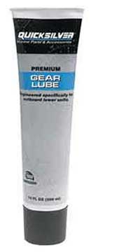

This is the type of tube VicS was referring to.
Well this is actually what I had in mind.
The tube I bought in 1985 and have been refilling ever since.
