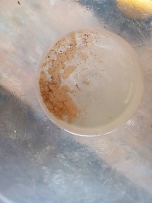

My Honda 2.3 started playing up a few days ago - started fine but stopped a few minutes later, kept starting then stopping after a few seconds so rowed the rest of the way... On return journey to shore it ran OK without any problems. Took home and stripped the carb. Opened drain screw on carb first and water visible - removed carb bowl and 'pink' blobs found. Stripped rest of carb, cleaned and reassembled. I've used Premium petrol with Honda additive for the last couple of years. What's the pink blobs? Having lunch so not run it yet. Pic shows the water(other wouldn't load!)

Update - definitely not rust, the inside was clean, the pic shows the water, the other pic showing the pink blbs didn't upload! Ran it for several minutes and it ran ok. Will try on Thursday when I go to our boat.
Fuel/ ethanol residue. Two week old fuel in a float bowl will have water in the bottom of the float bowl.
