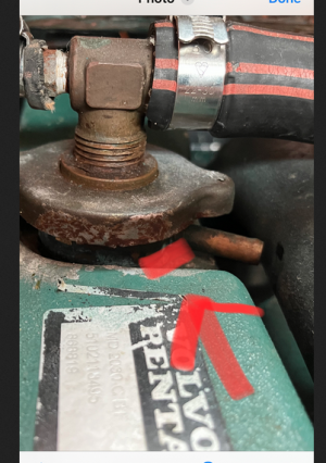

Hi, we have a failed filler neck (again) requiring new exchanger casing this time, we have had the copper rods banging against the casing also damaging them, so killing 2 birds really,. for £2k!, I am looking into modifying the connections to the expansion vessel, they currently go through a modified filler cap that clearly is putting too much stress on the filler neck.
Question is, can i simply engineer a manifold with 2 connections for the vessel (feed and vent) and omit the pressure relief function?, ( not entirely sure there is a spring in there?, I just never want to touch it, 'cause its the achilies heel of this engine!!) I am pretty sure there is one on the expansion vessel lid? I could easily add a pressure relief valve as well.
I think we are going to simply have what engine was designed to have in the short term once replaced - just a radiator cap and no hoses/ expansion vessel / cylinder circuit!!!, but we will want a shower at sea again one day!! don't know what will happen to the cylinder flow and return from the water pump, I guess they either blanked or joined?
any help hugely welcome
Thanks.

thanks, yes sounds like your on the same page!, ours has 2 pipes, one for bleeding air i guess, but just like on a home cistern, i'm sure that one would do it, and your confirnming this, I think that all expansion bottle caps have the pressure releif lid?, so yes, going to look at some proper threads and manifolds and get rid of the awful filler neck, made in a different metal and glued to the engine!!
i'm wondering if we can tee the expansion bottle into the flow or return to cylinder?, then the cap would simply need a manual air vent, probably not even that as we could vent by opening slightly till green juice showed!

just the way it came, ive seen it before for sure, can you tell me how it should be with an expansion vessel and cylinder on a higher level.?
i had a 2030 for 15 years and 3500 hours in a Bavaria without an expansion tank. What boat is it in?
I had a look through the Volvo parts list and can't find an OE fitting like that. Just a plain cap and no expansion tank. Also googled MD2030 images and every one shows just a plain cap. Suspect your add on is solving a problem that may not exist - and giving you grief!
My MD2030D was fitted with no expansion tank, just an overflow hose into the bulge from the hose fitting in the neck to the filler cap. I think that is normal arrangement.
Not liking the occasional antifreeze in bilge I fitted a plastic water bottle loosely over the end the tube. This arrangement seems perfectly adequate. My calorifier is fed from hoses that do not come off the radiator cap.
Chromedome identified this; I've seen similar set ups on a few VP installations, never liked the look of it.
1687161609428-png.158378
The whole thing is a bit of a bodge but I'm not seeing a reason to buy a new heat exchanger if the only problem is a detached filler neck and a damaged tube stack. A new filler neck can be fitted and a new tube stack is not a king's ransom, the wonky pipework can be replumbed with a bit of thinking to prevent a repeat filler neck failure.
I agree. But It’s there because the cylinder it heats is above the coolant level.
