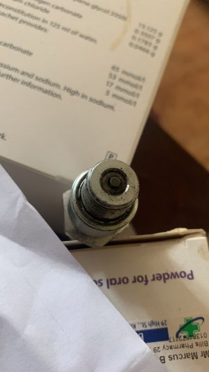

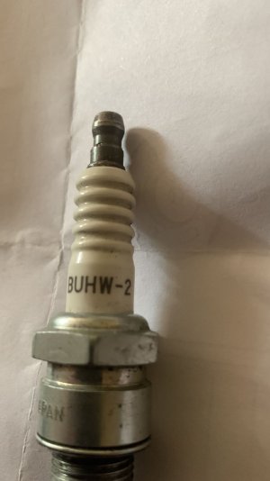

Hi capacitors ? do you mean rectifier , coil pack ive got normal spark plugs in it ngk, ive been told i need this type of plug but dont know

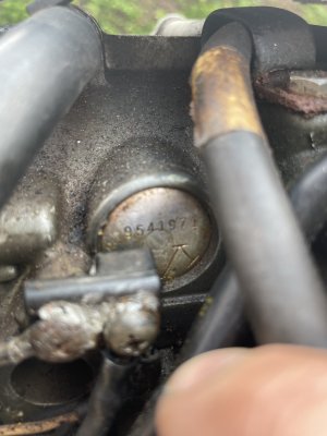

I did notice the plugs were wet when removed , so cleaned and heated up but no start , if i had noticed the vent wasn't open it may have ran fine because thats first time its been on water since ive had it , it ran fine a week ago in my barrel , think i need someone in birmingham yo have look at it to get running properly the gear cable popped off my fault probably for not tightening the clamp down enough but thats back on now just wont fire up engine number in photo . Dont know year if it has black or red stator i checked battery when engine was running it stayed at 12.43 volts .
