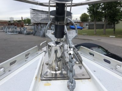

I'm wondering if any of you are able to identify this furler (apologies for the poorly framed picture). It could be quite old as it's on my 40yo Gib'Sea 84 and I don't know when or if it's been replaced at any point (the standing rigging has been). I thought it could be a Rotostay but it has a hole for the furling line and not a slot which I've seen in pictures of Rotostays.
It's getting quite stiff to furl so I'm thinking the bearings may need replacing.
Thank you in advance,
I can't help with the make but, if the bearings are plastic, my first step would be to give them a good clean with hot water. If they're metal, a good clean with a solvent to dissolve old grease, then give a very light coat of light grease to lubricate and protect them.
