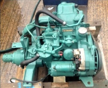

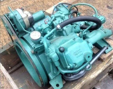

I've inserted a couple of photos of an MD5A -- NOT ours, but photos seen on the internet -- we just hope ours looks the same when revealed.
So, can anyone point out in these photos what we should be looking at?

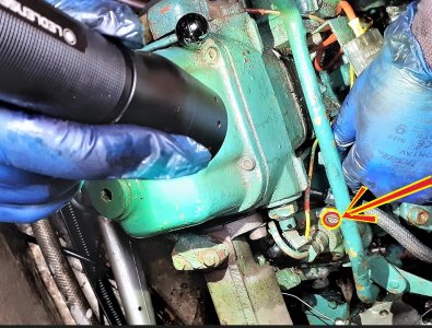

Have been at the boat today and was unable to find any kind of priming lever in all the places that there might have been such an animal.
We loosened the arrowed and circled slotted screw in the photo and continued to turn the engine on the starter until the diesel ran with no air in it.
After re-tightening that screw the engine started and ran "just like we've always known it."
Prior to last weekend it had been 3 weeks since it had been started but NOTHING had been done to ANY part of the fuel system in that time to have allowed air into the system. (There is around at least 8 or 9 litres in the tank.) Mysterious o_O

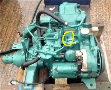

For reference is not the little lever ( yellow circle) not the pump lever mentioned in the bleeding instructions? I'm not familiar with your engine but from your photo's it certainly looks the part.MD5A_LI.jpg

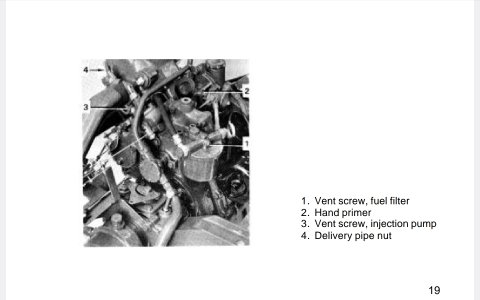

Venting is as follows:
1. Open the vent screw on the fuel filter.
2. Pump forward the fuel with the help of the hand primer until fuel free from air bubbles
flows out. Close the vent screw. If the pumping effect is poor, turn over the engine a
bit so that the pump drive cam alters its position.
3. If the fuel injection pump has been removed, or when starting an entirely new engine
for the first time, the fuel injection pump must be vent. To do this open the vent
screw on the pump. Pump with the hand primer until fuel free from air comes out.
Slacken the injector delivery pipe nut and turn over the engine by means of the
starter motor until fuel comes from the delivery pipe. Tighten up the delivery pipe nut
and start the engine.
