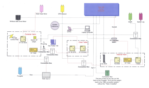

I have a system which comprises of older Autohelm systems and the occasional slightly later Raymarine unit.
A gyro was added to the system in around 2003 along with the Autohelm fluxgate compass. I’ve tested the compass as I have two and they’re ok. I’m assuming the gyro is ok.
In this diagram you can see the gyro sends A signal to the course computer but also the outside helm. When I disconnect the gyro from course computer I still get a heading on my instruments.
What I can’t determine is how the digital from the gyro is integrated into the ready of the system. It’s not going into the back of the ST60 wind or St7000. Where else might it be integrating into the system in order to feed the heading to the ST7000 and the E80 plotter?
The reason I’m asking is because my heading is off significantly so I’m trying to track down all connections to ensure they’re not loose or corroded.
