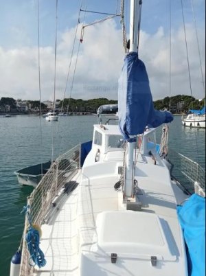

I’d think the Trident 24 has similar headroom restriction, and so this might be a worthwhile upgrade. My boat has no hatch garage, but has been fitted with a sprayhood in the past. I’d be interested in any suitable implementations out there.
This Trident, for sale in the Balearics, appears to have been fitted with a rigid sprayhood, and perhaps an associated “hatch garage”, but the photo doesn’t show much detail.
https://www.inautia.com/boat/1968-trident-24-9635227/
