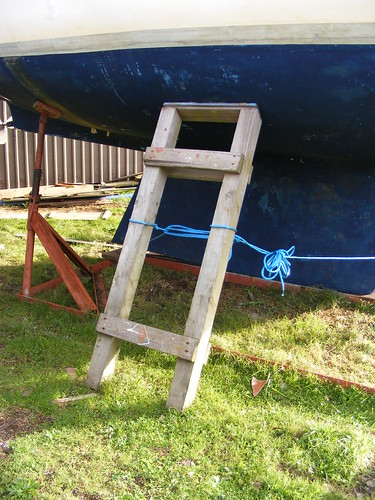

If it is on your own land and you want to go down this route make sure you have plenty of decent size props to spread the load, and preferably some under the bow and stern to avoid hogging if it is a wooden yacht. You will need wedges as well to get the props tight. Finally make sure that at least 2 pairs of props are lashed to each other under the keel, use a spanish windlass to get the lashing really tight.
Basically, timbers are wedged in the places that the legs of a cradle would be and then battens are nailed on, cross-bracing between them, to prevent them moving. Many people are successful at this, some get it wrong and the boat falls over!

Hi, a couple of railway sleepers under the fin, vertical supports fore and aft. 4 x 4 oak timbers, at least four down each side. 18mm ply squares with carpet against the hull. Dig out the ground for the side supports. If you are on concrete, you need to drill and bolt chocks to the concrete to prevent the bottom ends of the side supports from sliding out. Add double ropes from side to side and tighten the side supports with spanish windless.
Logs are fine, no need for expensive cradles!! BUT the logs must be braced so that the cannot fall out, the bracing can just be light timber 2x1 even. Try to brace across as well as along.
