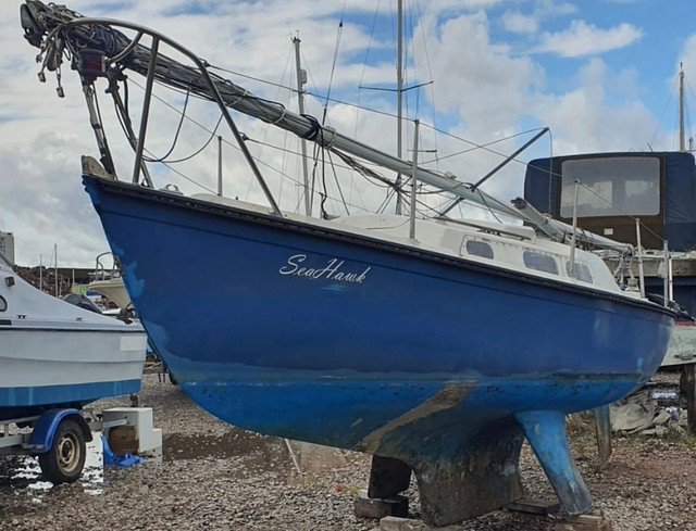

I used Seajet on my Achilles 24, which sat deep in Solent mud twice per day for years.
As I think you said in the other antifoul thread, the mud clung to the hull and the barnacles in the mud were happy to settle on the hull. My boat had spent previous years at Fareham (state of antifoul unknown) and my first summer with her (2019) in the Itchen mud. Getting the barnacles off before relaunch in March 2020 was days of unpleasant toil...
...but despite selling the boat in September 2020, I kept an eye on her for the new owner for 12 months before he could ship her to Germany. During that year the boat was unused, and when she came out in September 2021 I was surprised how easily the chaps with jetwashers shifted the barnacles.
Obviously the patch of grey there is the un-jetwashed area behind the hoist strap. But below the waterline is clean blue, given 15 minutes with the jetwash, after 18 months in grotty Solent tidal river mud. The keel was rough as can be and I'm not surprised it couldn't be cleaned.
So even though nothing will keep a hull spotless if it's parked in mud, the not-too-costly Seajet prevents the critters getting an immovable grip, assuming that when the boat's high and dry, you're prepared for a work-out with a stiff brush, or much better, if you have a jetwasher.
