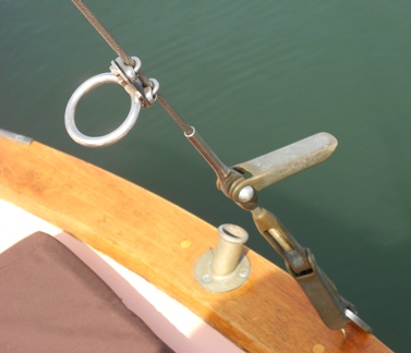

The new boat has a rather simple but effective backstay tensioning system, which is roughly similar to this:
On close inspection it seems to consist of two stainless 'handles' that just clip onto a normal bottlescrew (the one in the picture I linked to is a little different and doesn't seem to use a standard bottlescrew body).
Please excuse the thread drift but can you tell me what the ring that is u-bolted to the backstay is for ?

No idea- it's not my boat! I haven't really got to gruips with uploading my own photos so I just pulled that one off Google.
At a guess, perhaps it's for stowing a dan buoy?

I'm confused, a bottle screw is used to tighten rigging to the appropriate tension. A screwdriver shaft is used in the hole in the bottle, twist and tighten, not a handle. As for the two things on that stay I have no idea what they are, the bottom one looks like a lever but it won't tighten anything.

There are three things. The upper lever is unfolded, that's the one that keeps the wire and upper thread from turning. The other is on the central part of the bottle screw, folded down in the photo. That's the one that rotates. To the OP, sorry not seen one like that for many years.
I suspect the ring above the bottlescrew is for holding the lower end of a boathook.

The boat is an S&S, so I guess that's where the device comes from then.
The two 'handles' are made from a very small piece of pressed stainless sheet, I cannot see how it would cost more than about £20 to make something like that up...
I may 'borrow' the backstay one and stick it on the forestay...
