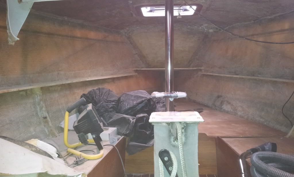

Finally got started. Using and angle grinder with wire cup brush, hand wire brush and Harris scraper (similar Bahco with replaceable tungsten carbide tips about 7GBPfrom B&Q) Use the scraper to get and thck foam and glue off and the angle grinder or brush ro get the rest off. I havent been ridiculously fasdtidious but there is no loose stuff and a lot of abraded GRPto stick to.
Horrible job.
But pleased with the Vacmaster Vacuum. Which is not recirculating the dust, the filter isn't clogging and the final Hepa outlet filter is clean.
Picture here:
http://i1205.photobucket.com/albums/bb425/17234/20140525_182843_zps604153fc.jpg
