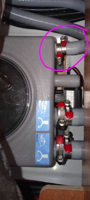

I seem to have an issue with my grey water holding tank, I had a shower on the boat last night for the first time and the shower struggled to drain.
I have investigated it today and it drains really slowly and I think it is a vacuum problem with the holding tank because if I remove the lid off the tank it drains immediately. I then run the shower with the lid off and it works great but as soon as I put the lid on it fails to drain and bubbles out the shower floor.
AFter some research it seems these have a breather hose that exits out the boat hull, how do I distinguish which is the breather hose and does it look any different to any other pipe exits on the hull.
I'm thinking this pipe on the top corner may be the breather as there is no sticker next to it but I can't trace where it goes
Has anyone come across this issue.
