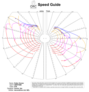

Depends on wind speed.
The stronger the wind, the narrower the gybe angle. Flying kites I'm doing 140TWA in 6 knots, 160 in 9 knots, 170 in 14 knots, as low as I dare in 18, then come back to 155-160 over 20 knots as I'm on the plane at that point.
However, with a genoa on a Starlight, I'd be pointing almost DDW with the Genoa poled out from about 8 knots. Simply because a roller furler genoa, which will have a much heavier cloth weight than my J1, will not be very efficient sailing deep angles in light breezes, but will be ok when supported by the pole. With your Gennaker, you should be sailing roughly the same angles as me in the light, but over about 14 knots you'll probably be better DDW with the poled out Genoa.
