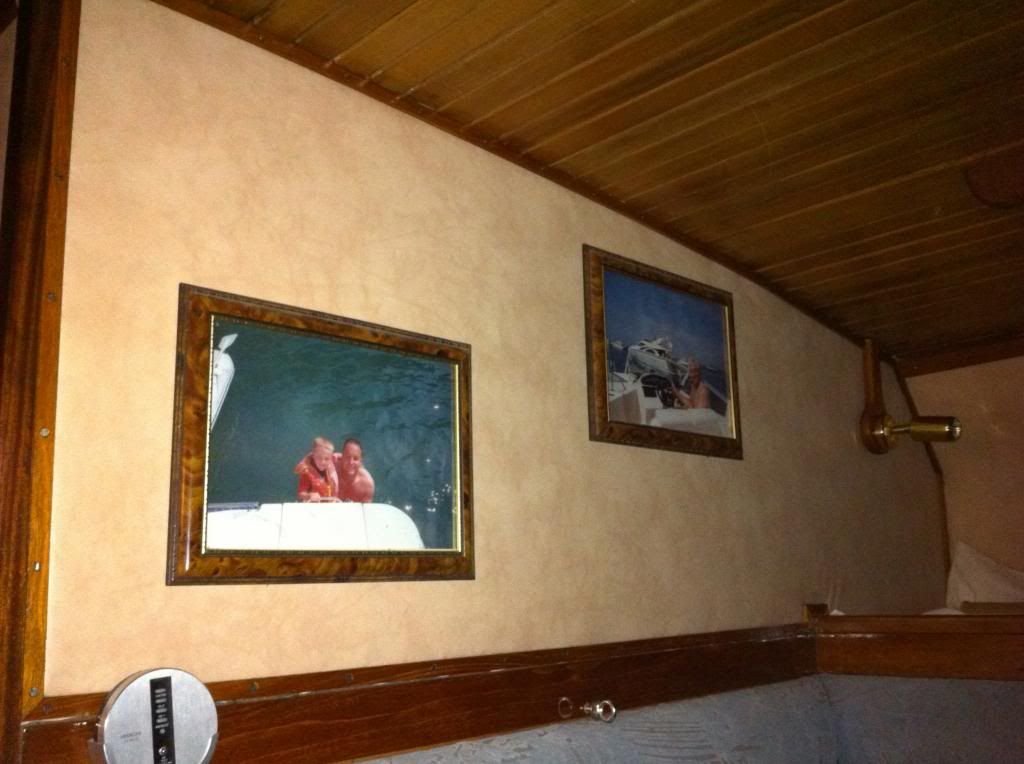

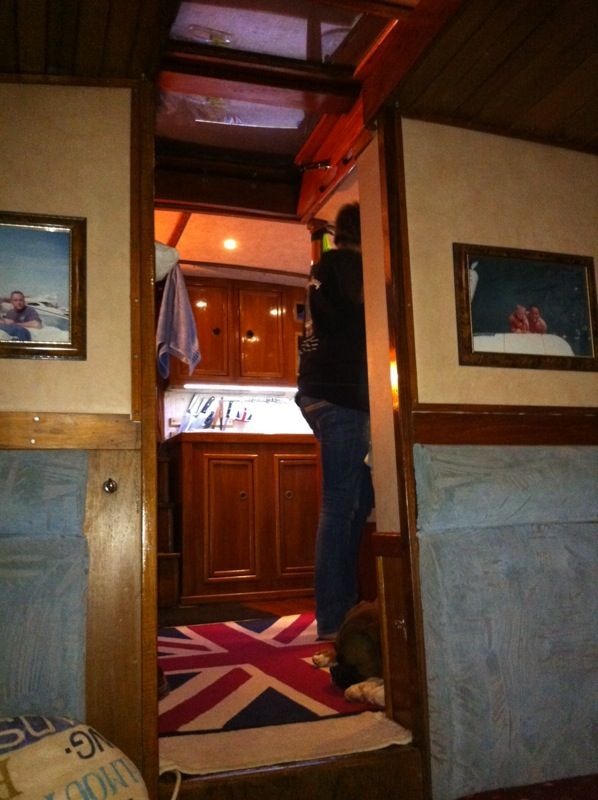

picture of leathercloth added to bulkhead using rot proof carpet underlay (in rolls- not folded) deck heads in the upper saloon are done in the same stuff, easy to cut the panels to add leds as well
http://i1090.photobucket.com/albums/i373/vert1go1/IMG_1113.jpg
http://i1090.photobucket.com/albums/i373/vert1go1/IMG_2866.jpg
