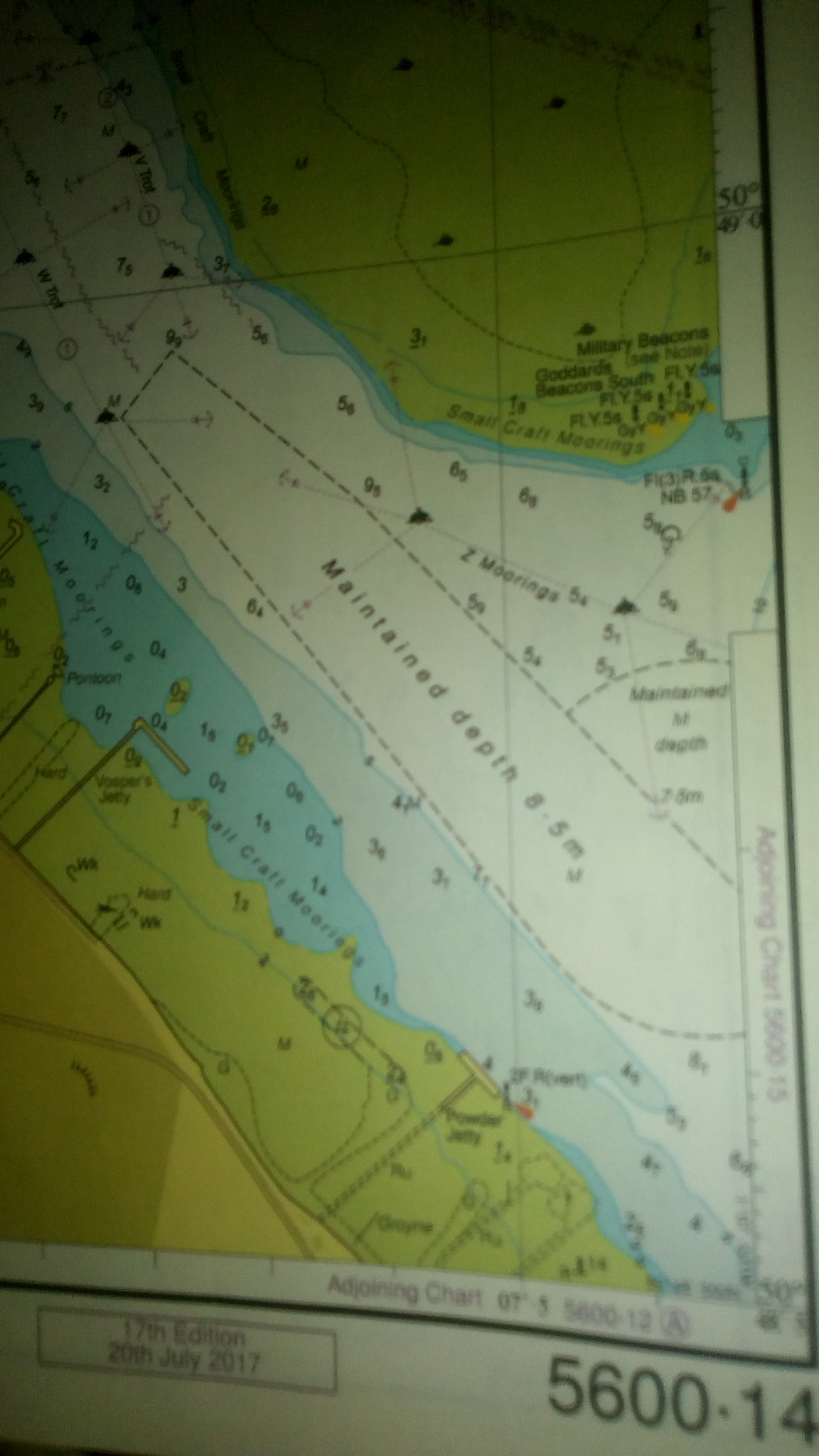

Having looked at the chart, depth the boats location in the small craft mooring area is marginal/drying. From line of sight from shore only it looks to be east north east of vospers jetty by a few metres. So I am not expecting much joy getting away early, in which case we shall not even attempt the passage home

If you keep pretty close to the Gosport side, there is a lot less current.
The main problem fighting the tide here is in Summer 'rush hour' when people bimble along at 3.5 knots in 3 knots of tide, so the boats behind catch up and people get pushed further across toward Portsmouth.
It's only a short distance along the HMS Dolphin wall, then you can turn right into the inner swashway.
Do check an up to date chart and LNTM, they have messed about with the channel for HMS Big Liz.
But at half tide you should be OK with the inner swashway. (I haven't done the maths for you...)
https://www.royalnavy.mod.uk/qhm/po...ections/2017/1702-portsmouth-harbour-entrance
If you are early or don't fancy the inner swashway, you need to stay just outside the main channel punching a fair amount of tide until you reach the outer swashway.
The green bit between the two is the northern tip of the Hamilton Bank, it catches yachts from time to time....
On neaps you should have no problem pushing the tide out of the harbour mouth. Turn right as soon as you are out of the harbour, there will be plenty of water. Follow Haslar wall direct up to Gilkicker. Follow the coast, no more than 50yds off, into Stokes Bay. The tide should turn west at Gilkicker around 1600hrs.
