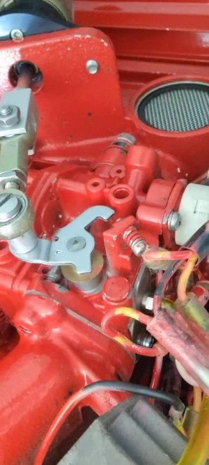

So managed to get over to the boat briefly today to run it with different appliances as advised. Now it's just starting, revving up then shutting down! I was hoping to get in there with some carb cleaner but that's as hard as taking the thing off.
Can't see why it was running ok the other day for 10 mins and now it won't run at all 🙈. I'm guessing it's time to get in there and get the carb itself for a good clean. I've attached a terrible photo of what I'm trying to get to but it gives you am idea of how very little the unit has been used.Screenshot_20230807_174621_Gallery.jpg
The quest goes on......
