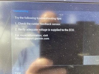

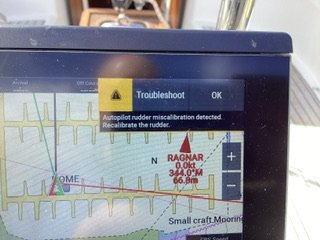

as already stated, GMI get its power from the N2K bus, plotter, a/p get it directly from the el.panel (at least should!)
My boat is 24V, have a 24->12 dropper that feeds the N2K bus which sits constantly at 11.9V (got the wrong dropper...) as I have close to 20devices on the N2K bus. Still all work fine!
Other devices and a/p is happy, my guess is some dodgy connection of the a/p ECU or dying batteries. GHC controller should report exact voltage to the ECU (iirc, was playing with the settings a couple of weeks ago) and you can configure the voltage for the low voltage error. Mind the warning doesn't disconnect the a/p.
Maybe post the exact message next time? is the digital compass properly configured? What rudder sensor have you installed?

Thanks Vas,
Here are the messages that I’m getting on the Chartplotter.
Rudder position on the GHC 50 appears to be correct despite the message.

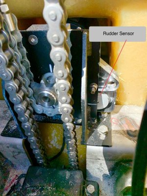

Here is the steering system looking forward. The rudder sensor is mounted on the Lewmar Integra drive unit.
Lewmar initially denied that this sensor was anything to do with them but after a bit of back and forwards they conceded that this was their design that never went into production. They have no idea how it got on my boat, and neither do I.
It’s a potentiometer connected by a small belt to the Lewmar drive.
I’ve removed the drive and checked the potentiometer. It seems to be working ok and the rudder position on the helm control always seems to be correct.
But yet, it keeps failing, absolutely randomly.

doubt I can be of any help as I'm only familiar with hydraulic A/P systems using a garmin A/P pump...
Wonder, how this rudder sensor contraption is connected to the system?
Does it somehow "mate" with the Garmin A/P, is there a converter that brings the data to N2K bus?
and how is the steering motor thing whatever that is connects to the garmin ECU?
I wonder if the A/P system would work without the rudder sensor?
TBH, I'd be tempted to unplug the thing and see what garmin thinks of it :)
maybe it's going to work better :rolleyes:
May have to rerun the config of the A/P

I don't think rudder sensor is voltage sensitive. But, i'd carefully check the voltage at the ECU as well as checking all connections.
The Lewmar unit is a rotary drive, commonly fitted to Bavarias. If it's faulty you might be able to fit a Garmin rudder sensor to the steering quadrant at the transom.
Yes, my plan is to fit a Garmin GRF 10 rudder sensor to eliminate that as a source of the fault.
