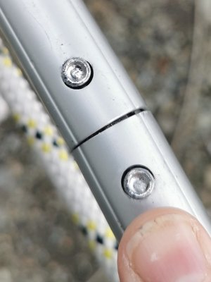

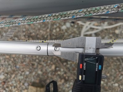

3 Nov 2025 #1 PabloPicasso Well-Known Member Joined 12 Feb 2010 Messages 2,926 Visit site Hi all Anyone know how to remove the fixings on the foils of a Seldén Furlex 104s? Attachments IMG_20251103_105601_edit_967661628370051.jpg 134.7 KB · Views: 8 IMG_20251103_105733.jpg 792.5 KB · Views: 8
3 Nov 2025 #2 Supertramp Well-Known Member Joined 18 Jul 2020 Messages 1,379 Location Halifax Visit site I think you need to move the inner sleeve away from the join to allow it to twist and release the joining plate (which the two heads are part of). Picture may help explain the parts. I can imagine any corrosion will not help.
3 Nov 2025 #3 PabloPicasso Well-Known Member Joined 12 Feb 2010 Messages 2,926 Visit site Seems the bend is not too bad. With a little gentle persuasion it's straightening up OK. Is this straightening of the foils likely to result in a usable furler?

3 Nov 2025 #5 Supertramp Well-Known Member Joined 18 Jul 2020 Messages 1,379 Location Halifax Visit site Probably. Remember aluminium doesn't like being bent (permanent distortion) repeatedly. If it looks ok and the track is ok then move on.
