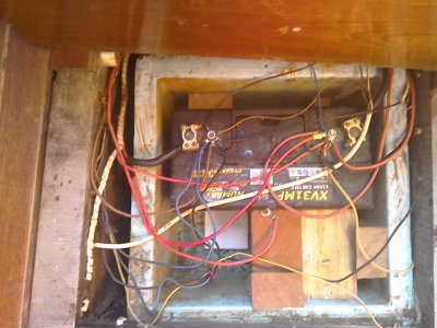

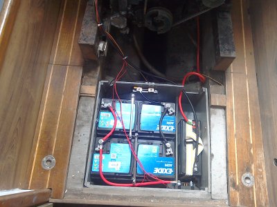

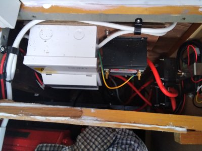

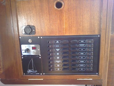

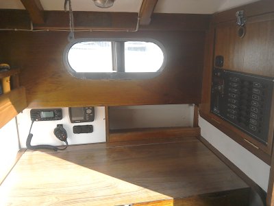

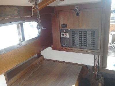

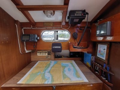

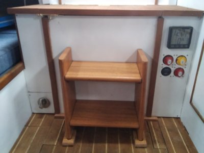

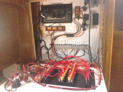

If you break it down into smaller chunks it can be manageable. I found stripping everything out and starting again was best, but you can see from the photos how horrible it was to start with. If you are doing single engine and just start and engine banks the heavy stuff is probably easier, particularly if your batteries are close to the engine. I used bus bars and a BEP Marine switch cluster with VSR which eases wiring. Made most of the cables up myself with a heavy duty block crimper from !2 Volt - in fact nearly everything came from there.
Photos show before and after for the batterie but the after is not fully wired at that point. Rest are old and new DC distribution panel. Last 2 are a not very good shot of the bus bars and 240v CU plus the BEP switch cluster. Hope you find this helpful
