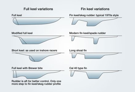

While I don't think it's definitive, the diagram in the PBO article seems to cover it.
A full keel to me is one that runs from transom to forefoot and was the standard in the days of wooden boat building where it was integral to the structure, and the ballast might be internal or external. A full keel will be a long keel, but long keel can cover a lot of variations as in the diagram, and is not necessarily the full length of the boat and not necessarily with the rudder on the aft end of the keel.
Like many descriptors, long keel and full keel are not precise!
