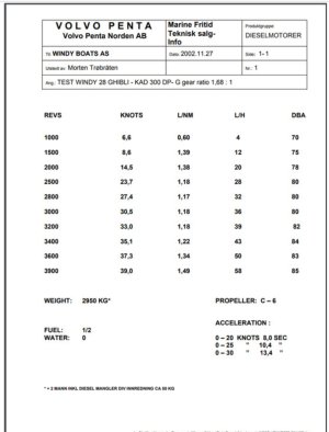

Interesting
The 10% below WOT is quoted time and time again. Without doing any measurement it’s always felt that just on the plane and a little bit more kind of feels comfortable with less engine strain. My definition of cruising. @Portofino data sheet bears this out from a fuel usage point of view. Also the dbA readings are interesting from a comfort aspect.
Conclusion
Cruising at 10% below WOT is just marketing
Interesting
Conclusion

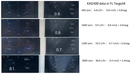

Little update from a friends targa34 with KAD300.
Always felt i got 1.5mpg in my T40 cruising so data should be transferable at slow chug 1,000 KAD300 fuel use data.jpg
