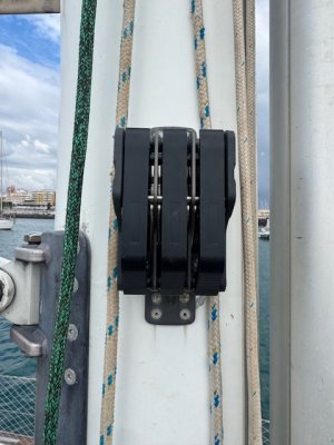

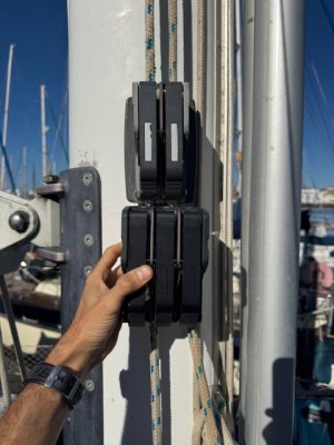

This is my mast. It’s a thick one piece proctor mast. There is a double clutch mounted on an alloy fitting plate. I want to add a triple clutch.
If I remove the double and add the triple, I would need to drill 6 new holes. Between which the old holes would be.

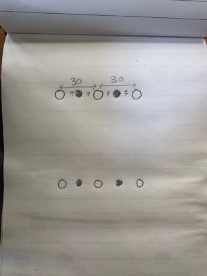

The old holes have around 21mm separation. If I drill 6 new holes, there will only be around 7mm separation. See diagram. Grey circles are the old holes.
My questions:
- Will 7mm spacing be sufficient for the new holes?
- If not could I fill the old holes with JB weld or something to help support. Or maybe screw in a helicoil to help support the hole?

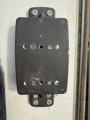

Yes sorry I should have been more clear. There is an allow pad already. You can see it behind the double clutch. Could I mount it offset on that pad… hmm not sure

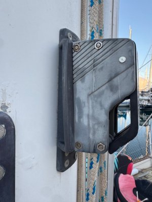

Well the existing allow pad or bracket is already riveted to the mast. 4 holes. If I take it off and add the triple clutch, I then have 8 holes in the mast in total, if you include the 4 from the old mounting pad / bracket. I don’t like that idea really.
I’ve added two more photos of the bracket / plate to the original post but here also:
Would the triple mount on the existing pad or failing that I would just mount the single along side on the mast, or could the double be moved over leaving room for the single alongside on the pad.

I think the suggestion is that you rivet/bolt the clutch only to the pad, and then the pad to the mast.. no more additional holes required..

Ah, not what I'd envisaged at all - are you certain the clutch is screwed through the mast? That base looks thick enough that it may not be (ie clutch screwed to base, base riveted to mast) . I think I'd start by drilling the 6 rivets out and having a look see
No it’s deffo not screwed to the mast.
Sorry I think I should have made a better initial post. The pad is riveted to the mast and the clutch is screwed to the plate. My question is that if I drill 6 new holes into the plate, will it weaken it sufficiently to be dodgy, assuming the 4 old holes remain. Thats my diagram. It’s a sketch of what the Selden aluminium alloy plate would be afterwards, with only 7mm clearance between new and old holes. The plate is large enough to accommodate a triple.
Well that changes it entirely then - I thought we were talking about a load of new holes in the actual mast at the gooseneck.
I’d go with it myself in that case. You’ve moved the worst case scenario from a broken mast to a cracked pad! That you can deal with should it happen, by keeping the halyard on the winch and to a clear.

True. And filling the old holes with something perhaps. A bolt with the top ground off might perhaps give some stability to the old holes. 🤔
