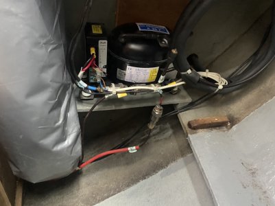

Our compressor was in the cockpit locker when we bought Serendipity and when I updated the fridge/freezer I put the new compressor in there too.
It’s inside a box that protects it a bit.
The side is obviously off the box in the photo…
No corrosion but the systems playing up atm. Hence my photo which I’d taken to send to Penguin who supplied it.

Edit: I’ve only just noticed tgat tge forum software has turned the picture upside down.
Are the cooling fins integrated with that unit, but hidden from this view? Or are they a separate unit somewhere else?
It’s a water cooled system. Sometimes described as a keel cooled? The red pipe disappears to the through hull fitting with the cooling loop in it. In cooler waters it’s very very efficient (so long as you’ve got lots of insulation round thd fridge/freezer). If we knock the thermostat by accident it freezes everything in the fridge.
However ambient air temperature here is 28-30C. In the cockpit locker it might rise to 40C plus? Seawater temperature is 25C plus or minus so it’s still more efficient but has to work harder.
