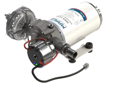

I have installed the best thing around Italy: MARCO ... very robust, no plastic, quit, electronic regulation, 12/24 V:
I’ve got the double pump version of that for higher flows. I’ve got 4 heads. (With a single pump in parallel as backup). A good system.
