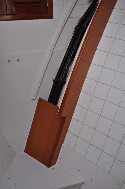

Inspired by seeing all the work with wood I've even turned my hand to doing some myself, such as this box to hide the pipe work in the forward heads:
