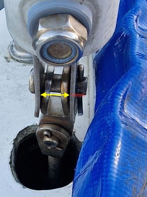

^^What he said ^^ - plus I'd want a longer clevis pin so a washer can go behind the split pin.Perhaps I'm being a fusspot but I don't like the way the lower stirrup has been squeezed to narrow it. This might have caused cracks.
And I don't like the way that not all of the blue plastic in the nyloc nut is in use.
Out of curiosity (well, and ignorance), what is the point of adding a washer in that situation?^^What he said ^^ - plus I'd want a longer clevis pin so a washer can go behind the split pin.
I always add a thin one to ease rotation of the clevis pin and to prevent the split pin (or tools) scratching and therefore rusting the (usually expensive) fittingOut of curiosity (well, and ignorance), what is the point of adding a washer in that situation?
