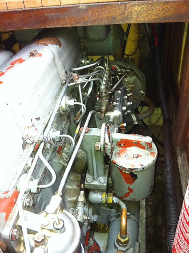

Thanks for that... it gives me the confidence I'm doing the right thing. My major concern is clearance. Looking at the photo, there is an oil cooler directly under the oil filter. Was yours the came config? Will the spin on filter clear the top of the oil cooler?

I think you can fit different filters ie longer ones and shorter ones (at least I can do this on current perkins) so if you pick the right filters should be ok
