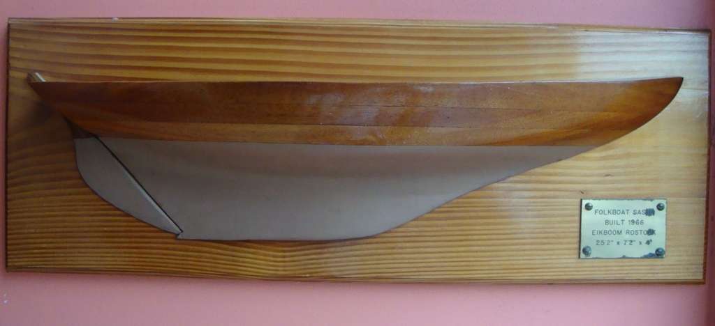

Very unfair to suggest that the east German built ones were anything but well built. They were certainly built to a budget but then again what boat of that size in the 60's wasn't?
They were mahogany strip planked , nailed edge on edge and glued, on steamed oak frames and built to a very high standard of workmanship. The decks and cabin rook were yellow pine and the superstructure and coamings ,mahogany. The east German ones had a raised dog house and higher superstructure than British or Scandanavian versions being more cruiser orientated. They were pretty competitive against their racier cousins in anything other than light airs.
To my mind those east German folkboats were as well built as anything from a British yard at the time and their longevity is solely down to their ownership and maintenance rather than their construction.
To build a Folkboat today ,identical to the east German ones would be hugely costly and would never be as viable as restoring a reasonably good original. Unfortunately there are not that many good originals around these days. They are superb boats and well worth cherishing.
Here is a half model I have on the wall at home of my old one, FB 408 Sasha, built by Eikboom, Rostock in 1968.
