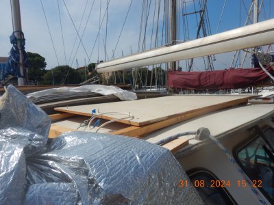

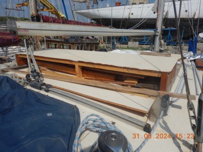

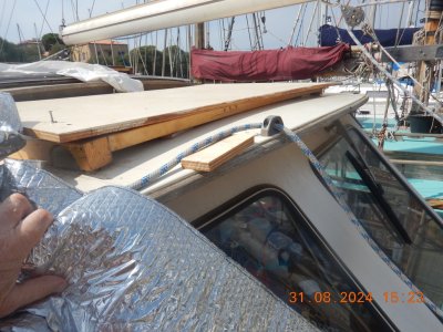

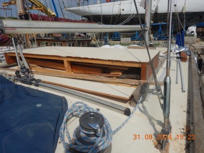

Hello Fellow Sailors.. I have my boat in Sardinia. Marina kept disconnecting the shore power anyway i have 5 dead batteries..
So I decided to install Solar system..
I made a couple of Bases out of wood and plywood. to have 2 x 100watt panels and 2nd Area 2 x 70w Panels FLEXIBLE..
Someone has just come up to me and Said " They Panels may Overheat and Cause fire" They need ventilation underneath. I believe the Flexible panles I will be getting sent from the Uk have aluminim backing.
Any thought and Advice would be appreciated.. I ahve virtyally finished the two wooden frames.. I just needed to Make they More appealing with hardwod covering.. I will attach Photos.. Plywood painted Cream then a clear polyurethane varnish . regards Graham

The overheating is invariably caused by cell damamge caused by repeated flexing over bimini frames. They can flex for installation, but not repeatedly.
Just secure the panels to the deck with screws or Sika 291. They will flex to the curve and be just fine. Ditch the wood frames, you don't need them.

When I installed my first solar panel, (17' boat, 10w semi flex panel), I used threaded studs and supported them 50mm above the deck to provide ventilation.
Subsequent installations were bolted direct to the deck using semi flex panels. No ventilation was provided and the panels didn't overheat. BUT this was in Wales not Sardinia.

Good installation you probably get some shading but not much. I had one installation very similar to this.

Thanks for the advice.. I do not have space at the Aft Are thats why i built fie trame it is Quite flat. - Yes I could of Just glued them down in the Bow area But It was easy enough for me to make a frame.. So they should not FLEX.. My concern is with the HOT sun in Sardinia. I see what you are both saying I Have ordered the panels from UK But thay have not been posted yet.. JUST WONDERING IF I SHOULD SWAP TO STANDARD SOLID SOLAR PANELS in ametal frame Mounted on the Plywood that may give a slight air gap. Prefer not too, as I would like to Walk (Gently) on this area.
The AFt area may get some ventilation - BOW are Virtually none apart from the slight gap at either end - SEE FRONT Photo.
On my cruising boat I worried about shading. Like the OP, these were installed just to charge the batteries at the dock. This boat is only day sailed. The battery is always up for the tiller pilot.
* No wiring-related neighbor boat problems. I've been burned before.
* Dock wiring can fail with winter ice storms. Also summer thunderstorms. No worries.
* I don't plug in anymore. One less thing to fool with.
It's enough to recharge a low battery in a few days. All I need. On my cruising boat I had 8 times more solar.
When actually cruising, it is common practice to swing the boom clear of panels while at anchor. Easy. You can even lash it to the shrouds.
