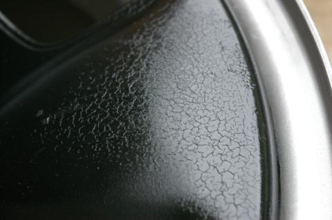

Following on from previous posts regarding my new toy and the need for a little 19GTS TLC in some areas.. I've fairly extensively researched getting the dash rebuilt as it currently looks like the attached.
I've looked at leather, relaminating, painting ect and it all looks like a couple of hundred notes to get it sorted when taking in to consideration carriage etc.. one guy quoted £500! Even the Felt yer thing's gone a bit Pete Tong as it now transpires the £50 is to provide a laminated sheet of metal with no fixings at the rear AND no holes for the gauges.. I now understand why it was so cheap!.
So.. I'm going to have a crack it doing a DIY job using enamel paint... watch this space for pictures, it'll either be an amazing cock up or something better than the attached! :) Whatever happens , I'll do a step by step pictorial guide to the steps I've taken to allow other Fletcher owners to see how (or indeed, how not) to carry out a dash repair..
should be all done and dusted within a week as I'll be doing it bit by bit in the evenings after work.
wish me luck.. reckon I'm going to need a bit ;)

Here's the progress so far:
Sliced away the majority of the peeling laminate using a thin flexible blade taking care not to score the metalwork
Used one of these to melt the stubborn bits rather than put too much pressure on the knife
result is all the laminate off but still left with some glue
a bit of wet and dry put to use to get shot of the glue.. notice the small pitting where the laminate had peeled away leaving the metalwork open to salt errosion.. shame
all sanded down and degreased with white spirit.. pitting now really evident but not too bad and to be honest, not much to be done about it.. hopeful the paint layers wiill hide it anyway
a couple of coats of enamel paint primer
and finally, not much difference yet.. a couple of coats of red enamel paint
will leave it overnight in the warm to harden up some more.. then give it a light sanding tomorrow and add a few more layers.. I'll add more layers for the next few nights to hopefully build up and deeper coat ready for compounding and buffing up. was going to finish off with some acrylic lacquer but have read it softens paint beneath it.... should have put it on first apparently and then put the enamel paint on top.. oh well :)
