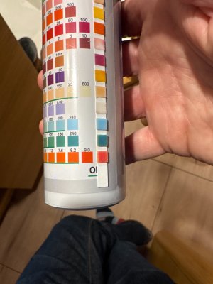

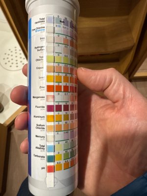

Bottled water is hugely variable, depending on the source. The results from the test strips look like normal hard tap water. The pH is on the high side but not out of spec. I am still not convinced the smell is from the water but don’t know if my suggestion from #15 was tried. I also thought about the calorifier but assumed it was the cold water that was affected. I sailed on a boat once that had salt water in the hot water from a cracked calorifier.By testing tap water or bottled water that is created for drinking you could find out if the results you just found were close to drinking water?
