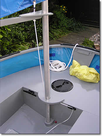

Not possible to shift the mast back a bit?
Thinking along the lines of a mast support to be located on the after edge of the forward seat with a " block of wood with a hole in it to locate the heel in the bottom of the boat.
Like a Prout Puffin:

Yes I think you will find it easier to sail to windward with a jib. If only for the easy identification of luffing.
I would think that moving the mast back a little would be better and fit a fairly small high aspect ratio jib. ie tall not too long in foot but mounted to the bow not a bow sprit. olewill
