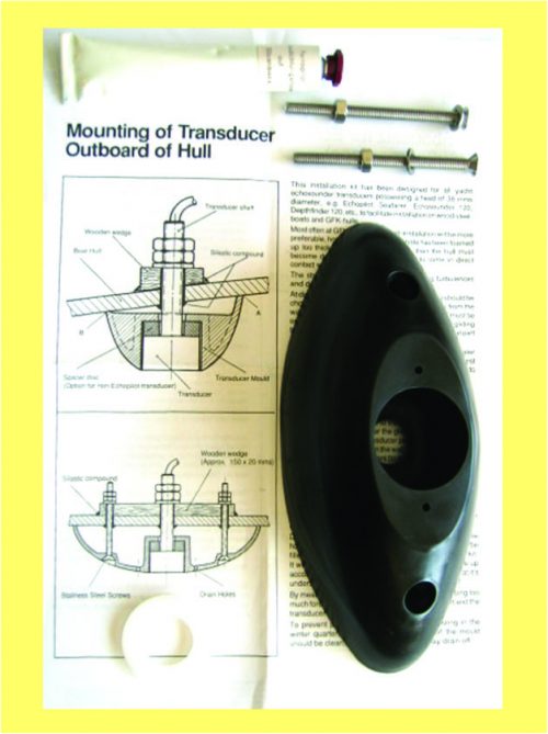

There is a nacelle at the stern whose bottom spends some of its time below the surface of the water, so I've wondered if would be realistic to build a little skeg under it for the log and depth transponders to live in? Another possibility would be to build a pod on a bit of stainless tube. In that case, my plan would be for it to be able to break free and tip up and astern if it hits anything, and also be able to be tipped up for cleaning. I'm guessing, the transponders would have to be the best part of a foot deep (3ft draft) to give a reasonably consistent reading.
My only other idea is to drill through the hull at the current mounting point, as that will give me a horizontal top to the hole, and make up a custom version of the mounting kit for the bottom from GRP.
Good ideas or daft ideas? Any other suggestions?
