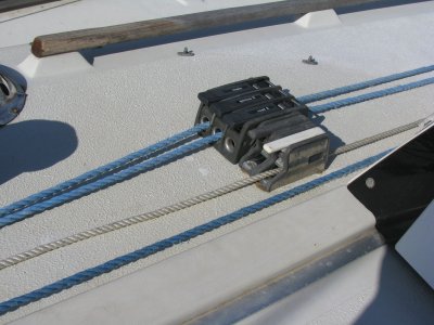

I assume you mean ones like these? I just used Plastic Padding gelcoat repair paste. You can see the plugged holes in my pic.
There are aluminium plates in the layup to which all fittings are attached. You can detect the extent of the plates using a household wiring detector. Then drill and tap for the new fittings. (These are not my halyards, winter substitutes only!)

See post #2. All fittings on Sadler decks are attached by machine screws into aluminium plates. No nuts.
