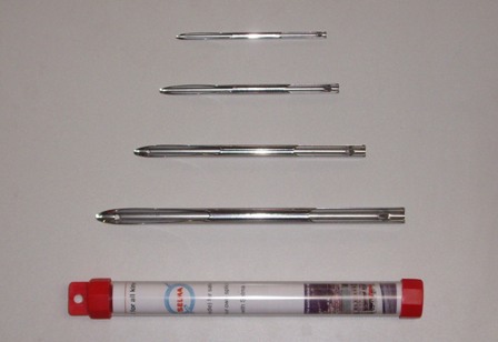

I've got a Selma Fid Set, it is awesome!
Really? I've got some of those and consider them a bit poor. The joint where the two metal edges come together tends to catch strands, and the shape of it is not as "streamlined" as it could be and is difficult to get through all but the loosest new rope.

The Selma fids works fine.
The classic ones, I feel that these are little bit clumsy to use.
Often end up using tape to get the rope hanging on to the fid

I have Selma fids and have had problems with snagging, and with getting either core or cover to go into a fid that is small enough to pass through the splice. I am going to make myself a couple of pushers from stainless rod and file handles. I reckon they will make the job a lot easier.
