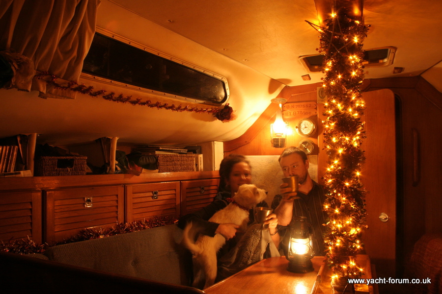

Can't remember exactly how much clearance I gave my heat shields but pickie shows what is definitely more than enough. I run the lamps all day during the winter on passage and so far over 10 years the headlining above the lamps is completely unmarked. As has been mentioned it is important that you don't headbutt them when you sit down so measure low enough not to warm the headlining but high enough to give bonce clearance. (And you must use indoor lamp oil.)
